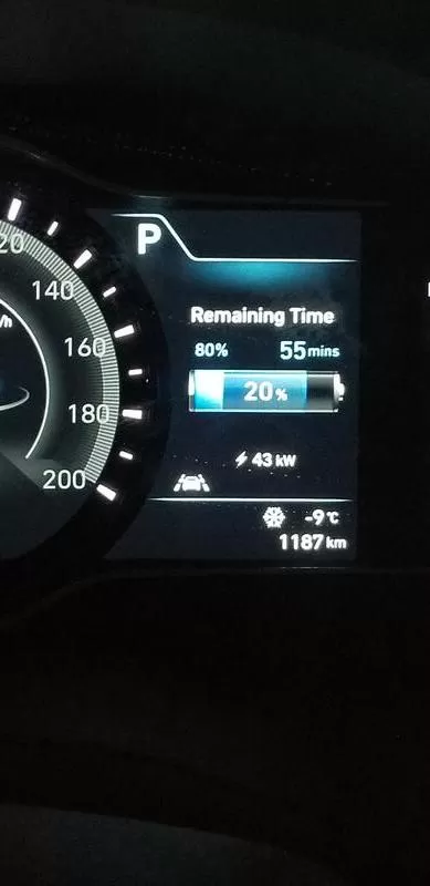

This is exactly what you can expect DC charging at -9C with a battery warmer. In this example I was driving an average 68 mph for 1.5 hours before I stopped for a DC charge at 20% SOC and battery pack temp was at + 12C from the driving( that is as warm as its going to get at that ambient temp, at -20C ambient you will be lucky to get above 0C pack temp). I was hooked up to a 250 kW DC charger and pretty much started at 43 kWh and quickly increased to 56 kWh because of relative warm pack and battery heater. I topped out at 78 kWh after the pack temperature hit 25 degrees from the battery warmer after 26 minutes. It took 30 minutes to deliver 32.8 kW. If I did not have a battery warmer my peak charge would likely not exceed 43 kw/hr for most of the session and would have taken approximately 32% longer( i.e. 32% more expensive if charged by the minute) to get the same amount of charge at -9C without a warmer.
