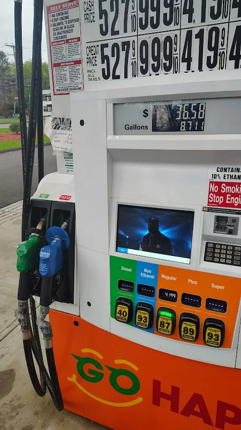

Wow that's cheap
E free is 9.99 here (pic from april). prices are about the same today.
