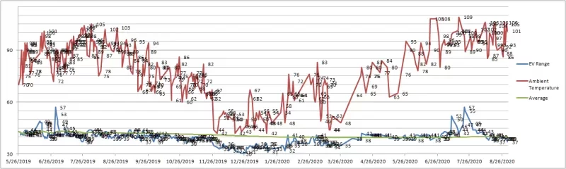

It seems your Clarity and mine are the only two that exhibit this 10 mile drop in EV Range. I'm wondering if we have anything in common that could be an underlying cause, or is it just a fault in the battery system.
In our case we, like many others, rarely ever have the ICE come on. So we are making maximum use of the Econ mode. Our daily drive is mostly to take our son to school and pick him up. Each is a 25 mile round trip. We take him to school, put on perhaps another 5-10 miles, then head home and charge back to full. We might make a short trip again charging back to full. Then we pick him up from school and charge to full again. It's possible to go out in the evening for a drive of 5-15 miles, then charge again. So it is very common for us to charge twice in a day, and can charge up to four times. I wonder if all of that charging and discharging (driving) is anything like your pattern?
For the first year (~25k miles) I was driving about 80-90 miles daily round trip. I would use up all/nearly all the charge on the drive to work, charge at work (about 80-90% charged by the end of the day on 120V), and then make it back home with ICE kicking in towards the end of the commute. The last 2 years has been a 40-50 mile round trip so I can drive to work with about 50% charge left over, don't charge at work anymore, and drive back with ICE kicking in at end of the commute.
For most of ownership, the cars gone through 1-2 discharge/charge cycles per day.
I noticed the sudden drop in EV range around Thanksgiving of 2019. During that week I was on a road trip and the battery was discharged for about a week in 40-50 F degree weather. I thought maybe that event caused battery damage, but it seemed kind of extreme for just 1 week of being discharged.
At this point, I've lost interest in trying to preserve battery capacity. I would rather have it drop below 36 Ah so I can get it replaced under warranty.
