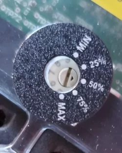

The Siemens Versicharge is a good EVSE. You might try changing the maximum Ampere settings for it and see if that helps. From what I remember, you have to remove the front cover to get to the rotary switch:
If you have the older 30A model:
Setting 0 1 2 3 4
MAX Current (A) 6 7.5 15 22.5 30
Power (kW) 1.44 1.8 3.6 5.4. 7.2
Copied from manual for the newer 48A unit:
Amperage Settings
Switch Position Amperage
0 12
1 16
2 24
3 32
4 40
5 48
NOTE: Do not set switch above the 40A unless hardwired via dedicated 60 A branch protection. Settings: 0 - 4 amperage adjustment settings are used for the 40 amp charger (note: the #5 position will cause a bad switch fault for the 40 amp charger) and 0 - 5 amperage adjustment settings are used for the 48 amp charger. Setting the amperage adjustment higher than 5 will result in a fault. • The purpose of the Amperage Adjustment dial is to set the maximum current that the EV is allowed to draw from the charging stations. • The dial has 10 settings. • Settings 0-5 are for amperage adjustments. • Settings 6-9 are for factory use only. These settings will result in a bad switch fault if used.
It was at 75,%, I lowered to 50. No change...
