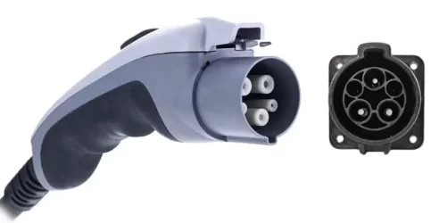

I bought a Clipper LCS - 20 around 2014 for my 2014 Volt (2014 Volt, great car, but long since gone). Later put a chargepoint 32A in the garage for another EV. Almost sold the LCS-20, but fortunately kept it, and used it again after I had send the chargepoint back to be repaired, twice.
Now, with two EVs, the LCS-20 is on the outside of the home near the driveway and still works perfectly!
Cleaned the plug pins, and coated them with a tiny bit of DowCorning #4 (a dielectric grease), and got a cap for the plug, and drilled tiny holes in the cap to drain any wind driven rain.
