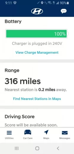

I have good news to report. On April 16, 2022, I had 35% Battery Remaining and I decided to charge at home using my level 2 charger like I always do. Much to my surprise, my mileage after steadily declining (see line 3 above) jumped up to 316 Miles. So maybe it was the fact I had 35% battery left. I will find out by charging it again when It is at the same 35% Level. Or does anyone think that the one and only time I used the DC Fast Charger (March 30th) with an 89% Charge when I started, had a positive effect on my battery?
And so the revival of additional range begins, more likely due to warmer weather.
It couldn't have hurt the pack charging to full with the DC charger (hopefully no one waiting behind), may have even initiated some top end balancing.

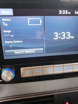

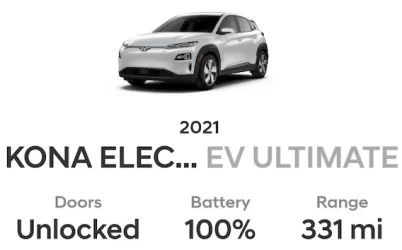

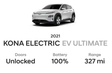

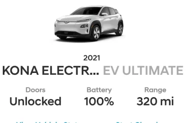

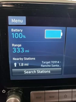

I am Happy to report that since I posted the above, my Mileage has steadily increased from a low of 305 miles with the next charge being a Major Jump to 320 miles then increasing to 327 miles then to 331 Miles then to 333 Miles on September 2, 2022. Since I don't drive much (4810 miles in last 13 months) I only charge my car approximately every 3 weeks, city & freeway driving only in Southern California and always in Eco Mode. The amount of charge remaining in my battery ranged from a low of 1% to a high of 28%. I have attached screen shots I took of my mileage. Most were taken off the My Hyundai app. But the 333 I took off the Cars Screen including the 1% left in my battery that later dropped to Zero but I didn't get that pic.

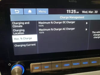

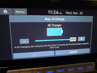

Electriceddy I am puzzled. I have the 2021 Kona Ultimate EV and it has AC & DC settings to charge the battery to any level I set it to between 0 and 100% See attached Photos. Are you all discussing something else?
They are talking about charging rate, not total charge limits
