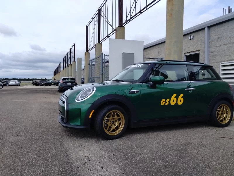

Do you like my big brake conversion?
15" 10.6lb SSR wheels. I may have accidentally touched both rear calipers with a belt sander. Fortunately, not a highly stressed area. Tyres are Nankang CR-S 225/45-15 front. Yokohama A052 205/50-15 rear.
