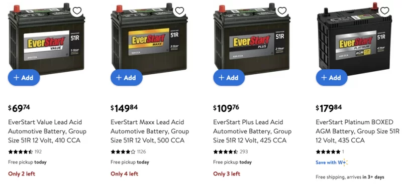

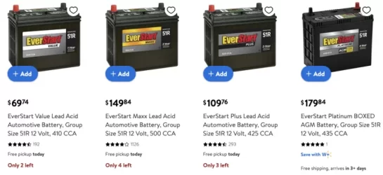

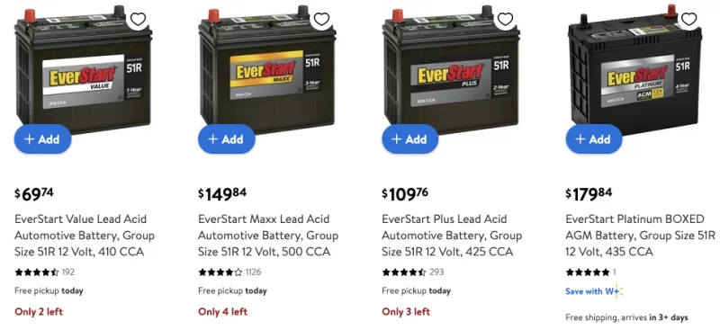

FYI Walmart has 4 versions of the 51R battery, Value, Plus, Maxx, and Platinum. The Value is the $70 one with lowest but sufficient CCA.
I just picked up the $109 one yesterday. I had the car on "start/stop button twice w/o brake" for like 30 mins listening to the radio while I was putting in a new dashcam then the car started to throw all sort of error messages. Checked the batt and it was down to 11.9 volt. Not too bad but I figure it's time.
Went ahead and joined @JustAnotherPoorDriver and @David Towle with the $70 - 1yr Walmart battery. Car has 70k miles on it and the battery was nearly 7 years old. Last test was July 2024 at 191 CCA. I'm soon going to have to leave it for a couple of weeks and wanted it to start when I got back, so I went ahead and replaced it. I was probably running on borrowed time anyway, but I've had zero issues with the car behaving badly with the old battery.
