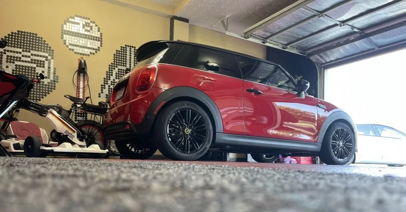

32099063-F6F7-42E5-86AC-9AAE5267D63E.webp 2022 Mini Cooper SE: Windows tinted at 20% in back and 30% front and also a clear bra the front of car w/PPF. Also 12 mm spacers all around with 215/50/17 to make wheels flush and fill the big fender gap.
Ride is much softer with the slightly higher sidewall and all season tires.
Only downside is the speedometer will be off by 2mph give or take. So 45mph is really 47 mph

That's actually a lot bigger of an increase in diameter than I thought... I'm considering slightly larger diameter tires as well to deal with the dirt roads around here.
Have you noticed any rubbing during sharp turns or on large bumps?
If you go with just higher sidewall like 205/50/17 you won’t need any spacers and no rubbing. I went 215/50/17 so I ran 12 mm spacers. No rubbing at all over speed bumps or sharp turns.

@Mini Monster Have you noticed any significant decrease in range with the larger/wider tires? Would you be able to share any other pictures? Directly from the front to show how flush they are and directly from the side to show how they fill the wheel wells would be very much appreciated!

Thanks! I did actually find that (and used it as a reference for my target offset).
