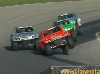

The effects of weight transfer are hard to see with a "sporty" car because there is essentially no body roll with the stiff suspension but a good example to help visualize is the ridiculous Stadium Super Trucks race series. Soft suspension trophy trucks on an asphalt circuit clearly show exactly what tires the weight is on as they pitch about through braking, accelerating, and cornering.
This is an example of accelerating out of a corner, the passenger rear clearly has all the grip:

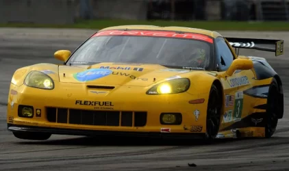

There is negligible body roll but absolutely not negligible weight transfer. You can have zero body roll and still have 100% weight transfer to the outside tires. Weight transfer is a function of center of mass height, track width, and lateral acceleration so unless the car's center of mass is literally on the ground there will always be significant weight transfer.
Even a lowered corvette can lift the inside wheels, just not as obvious as the trophy trucks:
