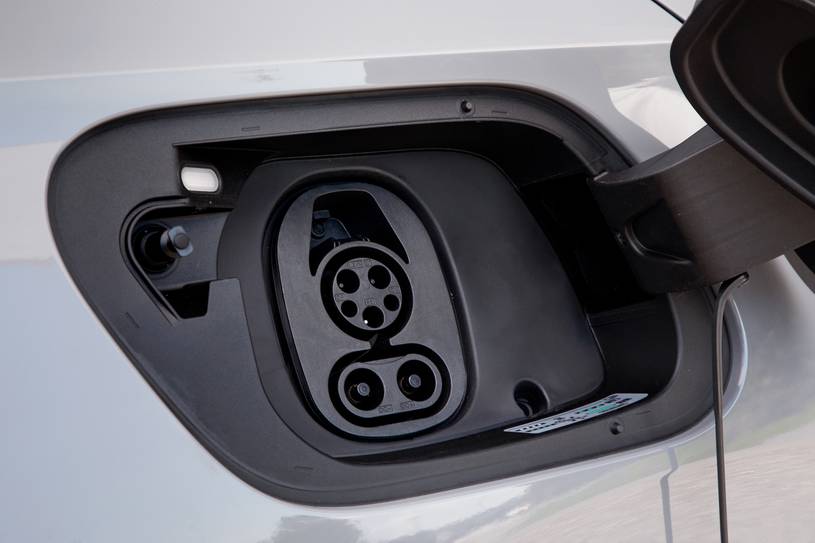

    The issue with the CCS connector is its weight and the multiple contour shape of it. Because it's rather heavy, it is not very easy to align the connector with the charging port quickly. Therefore, it's very common for many people to have to use both hands to align and plug in.
    The gas pump is similarly bulky and heavy, but to insert the pump nozzle into the gas tank opening is very easy because the nozzle is a small round tube and the gas tank opening is a lot wider than the tip of the nozzle, hence despite of the fact it's bulky and heavy, it's still rather easy to insert successfully.
    So it's not too much about the bulkiness and the weight alone, but it's more about the nature of the coupling mechanism which makes the bulkiness and weight become a critical factor.
    Because the Tesla connector is a lot smaller and lighter even with the CCS adapter attached, it's easier to align and plug even with one hand.

    Is it not “angled” on any other vehicle?
  3. fishbert
    fishbert Well-Known Member
    In the context of the criticism, I think the point was that the port on Tesla vehicles is not at a different angle than the car's exterior, which is one characteristic that makes it easier to line up.
    But yeah, in the world of CCS charging, "angled" charging ports don't appear to be all that common either: Ioniq 5, Mach E, ID.4, Bolt, e-tron ... even the BMW i3 has a charing port parallel with the body panel. The Taycan was the only other model in my small sample size with a (slightly) angled charge port.

    Those might be parallel with body panels, but none of them are vertically plumb. That’s what I’m on about.

    The vertical face of the port in most cars is roughly in line with the body.
    Mini have it tilted further inwards as if you are putting a gas nozzle in a hole which must ultimately lead downwards. The top of the port is further in than you would think and you can’t see it from above as it is blocked by bodywork due to being inset.
    They compound the issue by not illuminating the charge port but the giant CCS connector gives you almost no view either.
    The fact you have to perfectly align the outline of a very odd shape perfectly with the “slots” of the outline of the weird shape in the port is just not user friendly.
    The Tesla port is in line with the body, essentially flush, your view of it is not blocked, it is simply a squarish hood that tapers as the entire connector goes into the hole (no aligning anything is necessary) causing the connector to twist as it goes in and self align.
    The shape of the actual mating part and the fact it has to line up perfectly combined with the weight, size and shape of the “handle” often mated with a think, heavy cable and then in some cases compounded with no port light and ila mating surface not on line with the body means there is nothing, literally nothing, in its favor over NACS.
