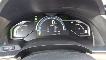

    Several exciting things happened to me and my Clarity last week.
    1. My EV range hit 50 miles for the first time ever. I found this very exciting (as background, I live in Duluth, MN and consistently got EV ranges in the low to mid 20s in my first several months of ownership).
    2. Last week, with early morning temps in the high 30s (daytime temps in the low 60s), my ICE came on when I pulled out of my garage. My battery was fully charged as usual (see image below).
    3. The ICE frustratingly stayed on for my entire drive to work (only a few miles) just like it was winter again.
    4. Strangely, even after I came to a complete stop, and the engine was off (I couldn't hear it), the bar on the speedometer stayed white instead of turning to blue. This happened again two days later. Additionally, even though temps have actually been WARMER (in the 60s regularly), I have never hit 50 miles of EV again. So, it's not just ambient temps that affect it. See engine off but only white bar in picture below.
    So, what does this mean (car has acted normal for the last two days)?
    1. Why did ICE suddenly turn on and stay on?
    2. Why no EV driving even when fully charged?
    3. Why didn't EV capability come back on when fully charged and stationary?
    4. What are all the factors that affect EV range beyond ambient temperature?
    I'm finding both my EV and HV range to be extremely accurate. But then again, I haven't put gas in for a few months.
