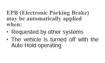

    This is from the US manual under One Pedal Driving:
    And then later under Electronic Parking brake:
