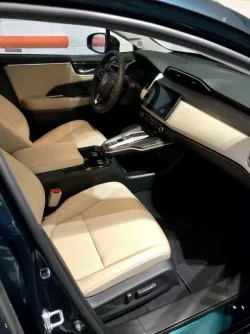

    05E53F15-E1FC-432C-A5D6-ACC53A3E19AA.jpeg F35E92ED-3E9E-4FE9-8CA3-34DAA097CA18.jpeg A918272D-B44B-4F4A-86F7-4D0DD28D21B4.jpeg 5FE18376-293E-4EC2-87B8-0E01539F2372.jpeg Greetings everyone, we are the proud owners of a 2018 clarity hybrid plug-in in green with tan interior.I have been driving the car for a day with no problems entering navigation information, adjusting the climate control, and other adjustments while driving. This morning, while my wife plugged her car in to connect to Apple CarPlay, some form of menu appeared and she assumed it was access to her phone but after connecting her phone to the Apple CarPlay she lost the ability, while driving, to make many adjustments to the AC system, navigation, and many other aspects of the user interface. While I have heard that other Hondas have similar issues, there has always been a way to enter the sub system through the head unit and to turn it off. However, I have attempted and watched several videos of other Honda's but these do not seem to turn off the distracted driver system setting on the clarity. In fact we cannot seem to find the actual toggle switch to turn it off. Can anyone help? The car was not doing this for the first few days and now it is much less enjoyable to drive. There is no reference to this in the manual or way to turn it off. By the way, when we stop at a light or in traffic, the system is now accessible but is soon as you start to move, everything grays out. Thanks so much in advance.
