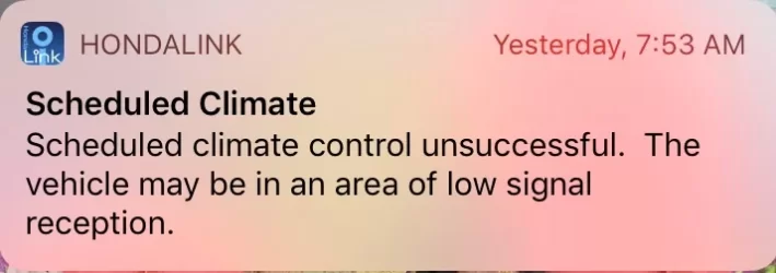

  2. Ram1234
    Ram1234 New Member
    Mine was giving below message everyday morning. Usually it is fully charged by that time. I never tried while charging. IMG_4101.JPG
