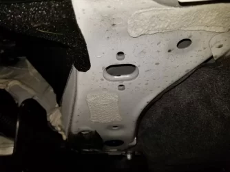

  9. JCEV
    JCEV Active Member
    I dont think I have the plugs

  13. JCEV
    JCEV Active Member
    Can someone post a picture of how the plugs look in person installed

  16. Atkinson
    Atkinson Active Member
    If I have it correctly, they are oval black plastic snap-in pieces in the location indicated by the diagram in the PDI doc.
    The two front plugs are more inboard than the rears.
    I pulled one off and put it back in.
    Hoping someone can confirm I have the right parts.
    JCEV, I get your question - I spent about 10 minutes second-guessing if I had it right.
  17. Carro con enchufe
    Carro con enchufe Active Member
    I found the holes and stuck my fingers about an inch deep. I assume this means they’re missing, right?
