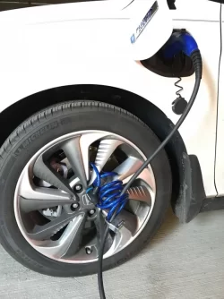

    This is how I secure the cable when I leave it for charging outside
    Texas22Step, Kerbe, V8Power and 2 others like this.
  5. KentuckyKen
    KentuckyKen Well-Known Member
    That is clever, Sriyad ! So I’ll use your method to amend my post to omit the aircraft cable loops and directly attach charging cable to ground post directly by a padlock.

    Cable-less method. Get one of the padlocks with the extra long shackle. Pull cable around behind the front tire and up to the plug. Gather the cable from both sides in front of the tire and put the lock around both.
