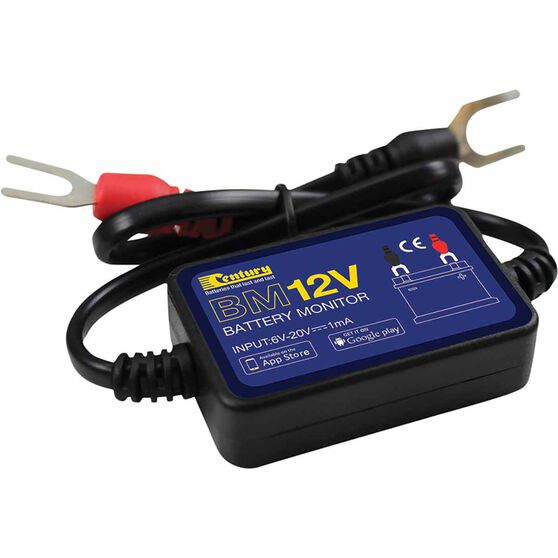

  2. I don't think this has been reported anywhere before. But I would suggest having a closer look at the 12V battery because I would expect that it's relied upon to supports the car's systems momentarily during a graceful shutdown. Buy yourself a battery monitor from Supercheap and you can monitor this easily with your smartphone. It's not practical to use a simple voltmeter to accomplish this.
    https://www.supercheapauto.com.au/p/century-century-bluetooth-battery-monitor---bm12v/601801.html#q=battery+monitor&lang=en_AU
    [​IMG]
