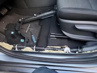

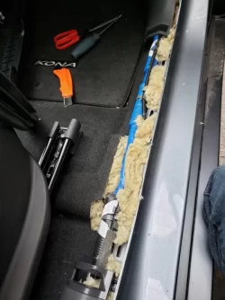

  13. driver side done.
    On the picture, you can see that Hyundai has put some good insulation under the carpet.
    I just put some insulation under the seat and near the hood release hatch.

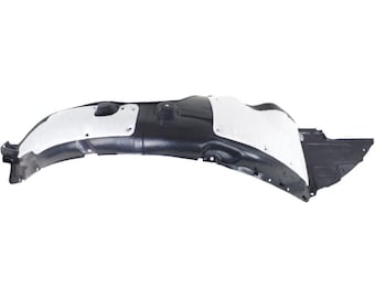

  16. If you have not done so yet consider putting some insulation on the back side of the front wheel liners, its one of the more cost effective tire noise attenuators you can do. Many OEMs already already do some degree of it already.
    [​IMG]
    Kirk, Bookbear and EVPower like this.
  17. Thank apu, I didn't think about this one but it make more sense. Will reduce the noise at the source. Will try to figure how what to used cheaply when I'll remove it.
