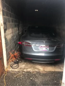

    • Sometime in early Dec we decided to spend the winter in Park City. I had a brilliant money-saving idea to move my Model S from our NYC lot to a much cheaper NJ lot. Naturally I asked if they had an outlet, and they said yes. Well, my wife goes to park it on Dec 22nd and it's the tiniest storage space in the world, and the plug isn't right in the same space.
      We're leaving for Colorado the next day, so we sort of have to go with it, and I plan to have someone plug it in if/when necessary, as we have an extension cord. At this point in time I didn't realize two things: 1) Teslas have 2 batteries - a 12V and the main battery and 2) if you let both batteries die for several months, neither can ever be resuscitated. The 12V is only a few hundred dollars, but the main battery is $20k.

    It looks like the images aren't working above. Here they are:
    Tiny Garage.jpeg Wrong Way - Charging Cables.png Right Way - Charging Cables.png
