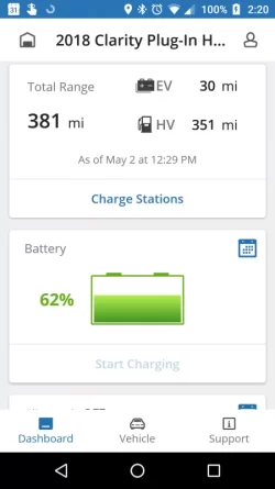

  7. aperson
    aperson New Member
    Thanks Jason and KentuckyKen for your responses.
    I should have made this clear earlier - I had already completed the setup steps as shown in the video. I have set my self up as the primary driver and we just use the same login on my Wife's phone too. With that said, here (attached screenshot) is what I'm seeing now when the car is sitting at a parking lot about 20 miles away. But when the car is home in the evening, I see proper values for both 'EV' and 'Battery'. I'm wondering why the discrepancy based on the car's location.

  10. aperson
    aperson New Member
    KentuckyKen, I think you are spot on about only certain events triggering the update. I was playing around with the app and think figured out how to trigger an update. Went in to 'Vehicle' --> 'Find My Car' --> 'Locate Vehicle'. Figured that when locating the vehicle perhaps there is a chance that the Range/Battery numbers are also updated. Bingo!!! Attached screenshot below. Notice the 62% battery remaining after a 26mile drive. That is about 28 cents cost base on my rates. Cannot stop smiling!! :)
