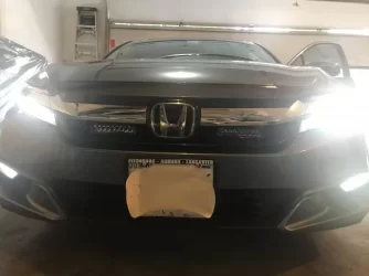

    After driving at night I was ok with the Clarity lights but wound up installing a pair of 6” Rigid SR-Pro series lights behind the top grill. I never reIzed how many different brightnesses of lights there were out there to choose from and I went with the driving lights. It made a huge difference to night driving.

    Can you please post some pics of the installation? Maybe the look from outside the grill? Were they a pain to install? Also did you tie into the headlight circuit? Just curious how you knew the fuses could take the extra load.

    ECC40DF2-442A-4E3D-B927-10D9BDDB5574.jpeg 4E7D99A0-13FD-4323-A168-C1592571C23D.jpeg 888F7AB7-72C2-48F4-B94A-05789088BE5B.jpeg Under the risk of being permanently banned from further posts for admitting this, I paid to have them professionally installed. They are on a separate switch. I used Eastside Motoring I Waltham MA, and had it done at the same time as my window tinting. I will try to get pictures from them because they created custom mounting brackets so the lights could be hidden as much as possible behind the grill. Installation ran $400 plus the cost of the lights, which was about $3000 less then it would have cost me to do it myself after factoring in a new bumper to replace the one I would have certainly broken!

    The look is good. Looks like they put some thought into it. $400 for the install doesn't sound bad to me. I agree that tearing out the front of the car would be dangerous for me to try. I did the horn replacement, but that is a lot easier than this. I haven't driven much at night yet, so I don't know yet how I feel about my lights. Its great to have an option if they are concerning once I get some experience with them. I really appreciate your post on this.

    They put a lot of thought into it. I brought the car in twice before they did the work so we could discuss different options. Originally I was going to put them behind the lower grill, but didn’t want to cut out the plastic and worry about the lights being too hot. The Clarity headlights were fine for me, but now that I have the lights installed I can’t drive at night without them.
