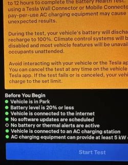

    The Super Bottle had a valve failure but it took two years to find out.
    A recent software update provides a battery test that always failed to run.
    That message should read, “No battery or thermal alerts, schedule service.” I am not sure how you get anything shown if “No battery.”
    Using the diagnostic, I found the service alerts:
