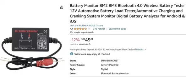

  10. On DC charging the vendor should be able to access connection logs. Of course they'd have to be cooperative. Our's are here but it's a small country and there would hell to pay if they didn't visibly assist EV owners.
    As for the 12V battery, get a BM2 voltage logger.
