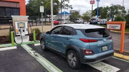

I still haven't received the replacement for my defective EVSE and even after charging 12 hours with the factory charger, my SoC was only 55% this morning. So, I decided to use the only local DC fast charger, a 50kw EVgo unit, 2.5 miles from my house... i charged up from 55% to 75%.. The fastest speed I got was 39kwh.. That's very slow. At least in the beginning at 55% SoC, I would expect 48 to 49kwh.. The free Greenlots 50kwh charger in Largo, FL gets me 48 to 49kw speed until I reach a higher SoC.. Advertising those EVgo chargers as 50kwh is false advertising as they don't provide 50kwh.. not even close.
Electrify America gets me close to 50 kwh too on their 50kwh chargers.. It's just EVgo whose 50 kwh chargers don't perform close to their rating. At 35 cents per minute, they should be faster.

The EvGo 50kW chargers I used between Las Vegas and Los Angeles were doing fine and I got 49kW delivered.
The only reason I can think of is that maybe the car was drawing less since you just went down the street to charge, so it wasn't properly warmed up like it is when you stop on a road trip?
I'm in Florida and Temperatures in summer rarely drop below 80F, 26C.. That's not the problem. The problem is that the charger is only rated 100 AMP.. I'm not the only one complaining about those chargers. Check the comments on Plugshare for the Lakeland, Florida and Bartow, Florida. Nobody gets over 40 kwh on those chargers. Like I said, the Greenlots Charger in Largo, FL (Largo Performing Arts Center) draws consistently 48 to 49 kwh below 70% SoC. Same goes for the Electrify America 50kw chargers. The EVgo chargers between Las Vegas and LA are different type chargers. In baker, they also have 2 100kw units (OLLIE and CHANCE) as also a 350kw unit (JANUS) as also a 175kw unit (IVO). Only ASTRID and NISKA are 50kw units and they are different 50kw units than we have here in Florida
I see, that sucks. Weird to put in a 50kW charger with only 100 amp. [emoji21]
Most EVgo units in Florida are only 100 amp.. I believe that the one in St. Augustine was 125 amps..
