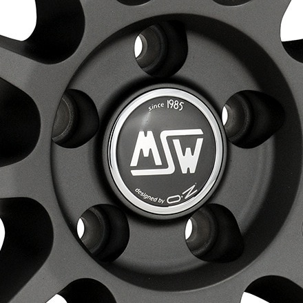

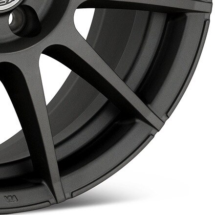

    I am using MSW type 85 17x7 45mm offset on my clarity PHEV - they fit and look good. Hope that helps.
    • [​IMG]
    • [​IMG]
    • [​IMG]
    Gunmetal Painted
    Size: 17x7 Offset: 45mm
