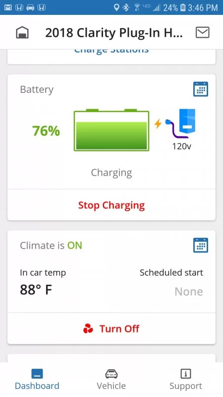

Honda's documentation for the Clarity says that preconditioning does not function when plugged in to a level 1 EVSE. We have a level 2 where we live in the winter, so I wasn't that concerned about it, but I decided to try it out here in our summer locale where we only have the provided level 1 unit. Sure enough, try to precondition over hondalink and you get a pop up saying you cannot. However - if you use the app to stop charging, preconditioning becomes available again, and the app shows the car as charging again when you activate it. In my test, the charge did still decline a little while preconditioning, but it does appear that it is drawing power - at least through the info on the app and the indicator light on the car (don't have a kill a watt, etc to check.)
So for those of you on Level 1 looking to warm up your car this winter, you can - just tell it to stop charging first. Screenshot_20180817-154650_HondaLink.webp

Yes, you can. But even if you don't make it all the way to 100%, all you have to do is press stop charging and you can fire it up.
Mine is kind of weird. I can do the same stop charging trick when charging. But that doesn't work once battery is full.
If start pre-condition from the app, it reports success, but climate is off on refresh.
Verified by placing a sheet of paper at the vent. Seems AC is on for one second, then off.
