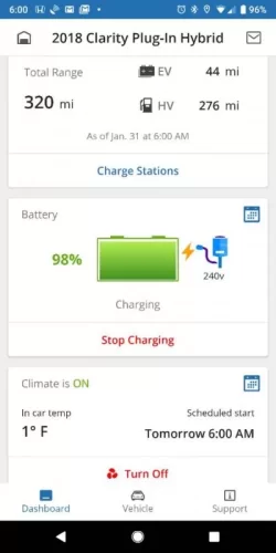

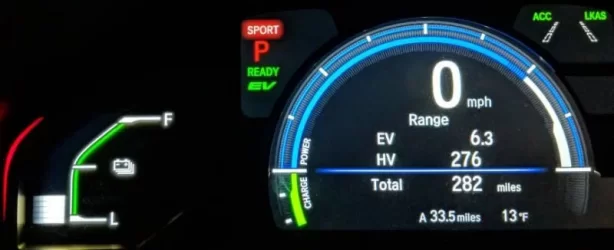

My USA model (no battery heater) was 1 F (-17 C, see HondaLink temp) this AM (parked & L2 charged outside), preconditioned 30 min (drew 2.6 kWh), drove 33+ miles roundtrip (see odometer A, resets with each charge), ICE did not turn on (note HV range unchanged at 276 miles). Car ran flawlessly.
I think preconditioning is key to performance at low temp, but obviously draws power while doing so.Screenshot_20190131-060056.webpIMG_20190131_212129.webp
I think preconditioning is key to performance at low temp, but obviously draws power while doing so.View attachment 3626View attachment 3627
