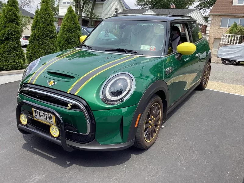

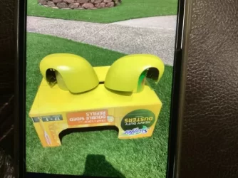

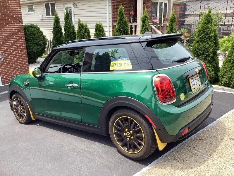

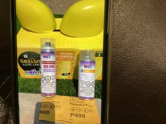

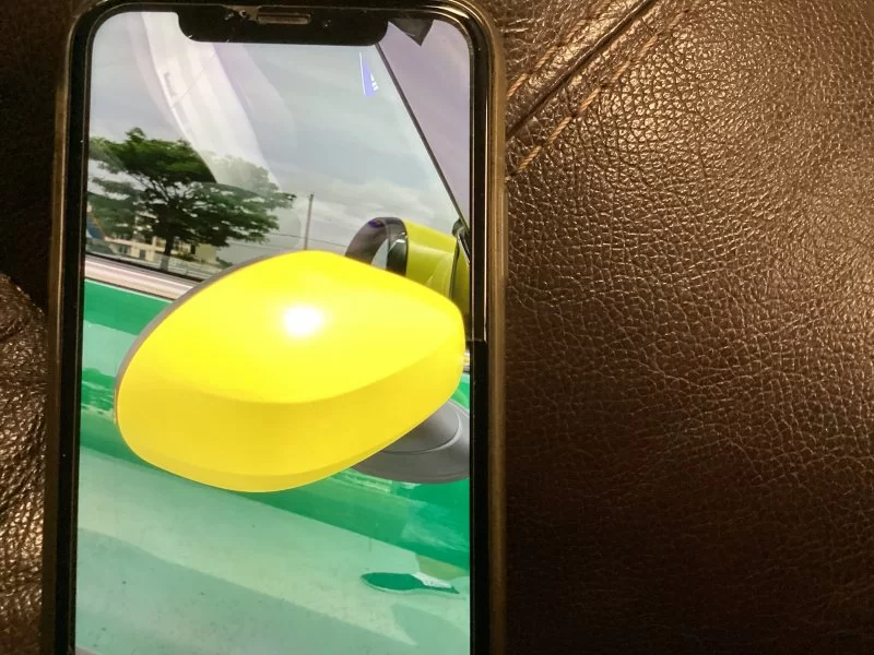

$50 paint and primer and 2 hr.work .Send a cups with 400 wet send paper clean with water and clean with rubbing alcohol let dry.2 coats of primer and send lightly clean with alcohol.4 coats every 5 minutes yellow paint very light coats .Don’t paint in windy conditions.I let dry in 80’ NY .weather and indoor over night before installation tomorrow.I’m very happy how a cups ,paint job looks.A pro painting shops were asking from $250- $375 for a cups painting job and a wrap shop $350 for both cups.IMG_0955.webpIMG_0956.webp IMG_0957.webpIMG_0958.webp

A guy in store open a book and we try to Mach a wrap yellow color which I use around my car on rims stripes on hood and he is pro with all kind of mixing equipment after a mix was done he put a paint under a pressure into spraying can ,picture with a phone and name of a store I put for reason maybe some members on forum need that yellow a can was $28 and bigger white primer $20 for those 2 cups I used 1/2 amount from both cans and they apply were well .
