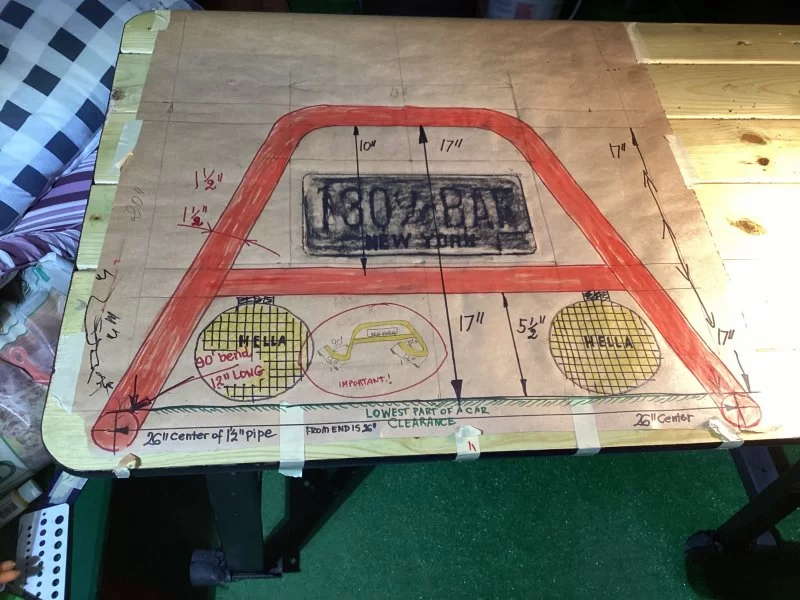

View attachment 16217 Is a design to be transfer into real thing soon . Is nothing there on a market to buy it .
Perhaps the best compromise to get the tough, bull-bar appearance without affecting crash protection would be a squishy plastic foam bull bar (then avoiding automatic car washes).I think @Rexsio may be the only one interested in attached a bull bar but I did want to point out that depending on how this is attached, you may accidentally turn a minor fender bender into expensive damage.
This may prevent bumps and scrapes to the plastic bumper but the bumper structure is designed to absorb low speed crashes with no major damage. Attaching something in front of the bumper to the car's subframe or other structure could cause some very expensive damage in even a minor crash.
