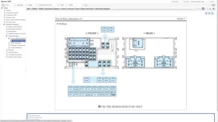

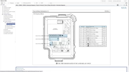

Hopefully it does. This is part of what is available for that MY:
Wiring colors are displayed, as well as terminations. Searching for other loads will be a bit time consuming as standard Hyundai manuals tend to be specific to particular systems. A very good (and free) resource as I have mentioned previously.
I would however definitely recommend to meter out (continuity check) associated wiring to designated termination points, just to be sure.
Good luck, hope to see your follow up post indicating another Kona EV out there c/w a happy new owner.;)

Electriceddy,
Thank you very much for your response and for this snapshot of what I can expect to find.

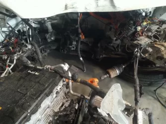

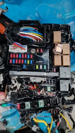

Check out how my fuse box is looking.....
Basically it is everything from about the Multifuse 1 and south that has been destroyed beyond use. The wiring underneath is relatively useable, albeit yanked out from their corresponding homes. The inset fuse subpanel north of the multifuse are all fine (and surprisingly none of the fuses in that section are blown). The relays had their tops clipped off but the corresponding terminals that are built into the fuse box in which these relays sit are all in tact so it is just a case of replacing the relays (I've already purchase a ten pack of the brown and 5 pack of the black relays so I can replace them all).
So just this snapshot you have provided already solves a large portion of what I am looking for around the multifuse area. I would say I will only need perhaps one or two more pages of diagram to be able to do the repairs I need. Of course, as you said though, it would be pertinent to try and zero them out to wherever they are going in the other systems of the car to ensure I do have everything correct before applying power, so having full access to the document is key.
I have purchased a generic set of fuses and holders so I can patch these in where needed to replicate the function of the multifuses around this damaged area. Once that is done the other jobs are:
- Replace coolant tank (Crushed/broken. New units are prohibitively expensive from Hyundai, I am just going to use a generic aluminium one with some weld-in barbs of the right size).
- Replace radiator, fan pack and the condenser for the AC. I actually have a Polestar 2 that I also got at salvage last week and that has no frontal damage of this pack, so I am likely just going to use the radiator/fans/condenser combo from that (Polestar is definitely a "piece it out" job. I mainly got that for the battery pack for my solar system).
- Replace coolant.
- Replace 12v battery (Casing was damaged, leaked acid).
- Put some 3.3 ohm resistors in the connections for the 4 seat belt pretensioners and the steering wheel and passenger dash airbags that went off. (Curtains and seat mounted airbags did not fire).
.... and then hopefully that should be it. I am hoping at that stage I will be able to power up with 12 volts, plug in obdii tool and see what codes I can clear and see if I can get the wheels turning.
The one element I don't know of just yet is whether or not the vehicle uses a pyro fuse in the high voltage battery pack whenever safety system items like seatbelt pretensioners or airbags go off. This is another dimension that I am hopefully going to discover in the full wiring diagrams of the vehicle. My salvage Polestar and the Tesla's seem to use a pyro fuse, however finding anything related to Hyundai/Kia's using a pyro fuse in their packs seems hard to find (and if it wasn't obvious, this is my first foray into Hyundai Kia EV's). I think I can see where they use a large typical cylindrical 450 volt 600 amp fuse in the assembly with the high voltage disconnect plug in the top/centre of the HV battery pack, however that just looks like a boring, standard old fuse to me, it doesn't look like it has any connections to blow the fuse in a pyro fuse kind of way in the event of any of the airbags or pretensioners firing.
Anyway, I'll get to the HV battery when I need to. For now I just need to get this fuse box wired and the coolant sorted to be confident that I have at least patched things to a useable level in the engine bay.

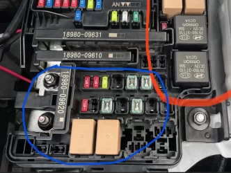

The remaining part to be done are the other items in the south end of the fuse box (see below marked in blue. Please ignore the nearby orange marking, that is a marking from this image which I borrowed from another forum...)
These items are relating to the 150 amp multifuse that I assume goes to the DC charging system, an 80 amp fuse that goes to the power steering system, around 7 or 8 fuses in the 10 to 40 amp range for various things and one or two relays.
electriceddy, If you were kind enough to post a snapshot like you did for the Multifuse 1 and 2 that would help me greatly.

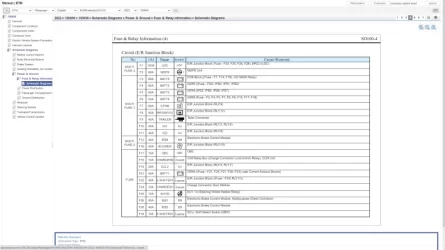

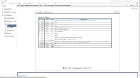

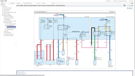

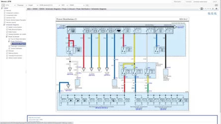

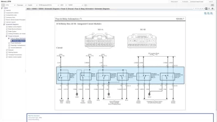

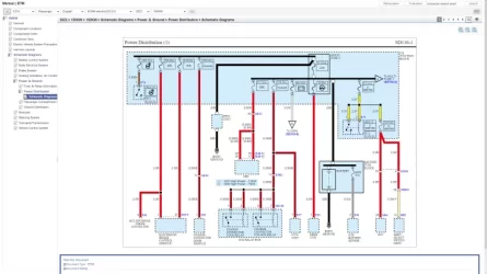

Yes agreed. That is the route I eventually had to take. I never did get any win from the Canadian libraries for Auto Repair Source.
Unfortunately for us here in Australia to access this service and pay for just one day of access you need to be a member of aasra to begin with. That costs $99 AUD for one year. Anyhow, I paid the annual membership plus the one day access fee and got what I wanted. I took the time to roll through much of what I needed and take snapshots using printscreen.
Interestingly, the diagrams were just a little different to the one page snapshot electriceddy shared earlier in this thread. I guess that is potentially the difference between models sold in our different parts of the world. So for us here in Australia these were the important pages that got me through what I needed...

I took the route of getting through aasra here in Australia for similar pricing.
I'm glad I did in the end, as it seems there are a few minor differences in the diagrams between what electriceddy previously shared and the ones I viewed for the model sold here in Australia. Or maybe it was because mine was the Extended range version, or perhaps some other specification/features differences. In either case I'm glad I spent the coin to get what I need for my specific model here.
