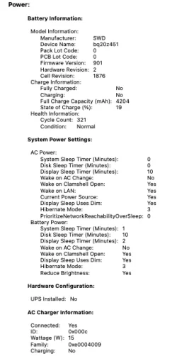

I plugged my laptop into the USB-C port on my SE and it shows 15 W power (bottom section of attached image, the "AC Charger Information"). I always intended to get an actual USB tester but never got around to it.
