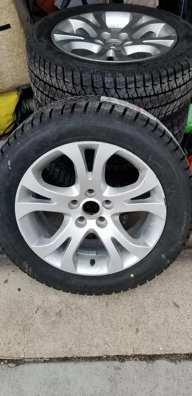

What!!! - no link with a picture?:D
I'm pretty sure you have seen these already but what the heck :)
