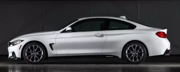

What is F 32 bc I thing small audience understand what you talking about as all those guys with self Parking future don’t know how to park a car without it .
2014-2020 BMW 4 Series 2 door.
