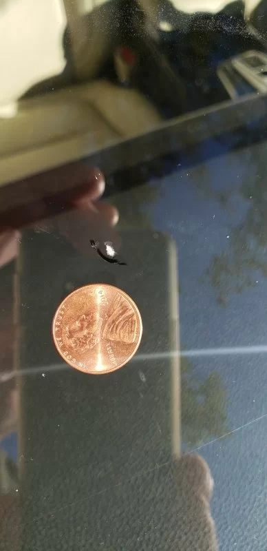

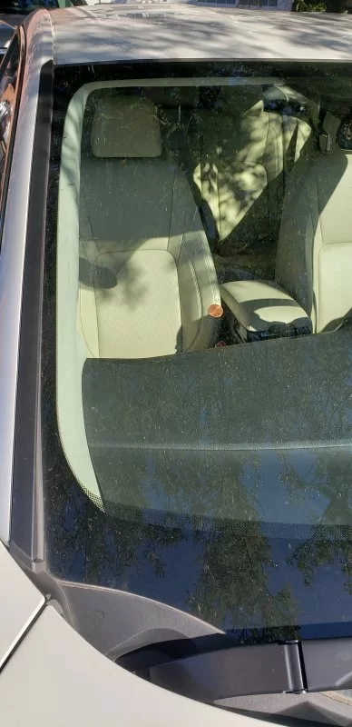

I thought I would join this thread to ask for some windshield chip advice. We now have a tiny chip together with a small crack on the passenger side of the windshield. I am attaching two photos. The penny is for scale but also works to show where the chip is on the wider view. Our insurance company will pay for a repair. I know our Clarity windshield glass is special. Our insurance company uses Safelite. Are they likely to know how do deal with a repair on our glass? Also as small as the chip/crack is, is a repair a good idea? Thanks for any advice with this.

I've had very good luck in the past with a repair. A good repair shop can make the chip nearly disappear.
Yes just get it repaired. It'll reduce the chip to looking like a permanent bug spot. Wait for a true crack before you have it replaced. The glass isn't special on the outside. It's just a pane of glass like any other car. Safelite can fill it and no special procedures are needed.
