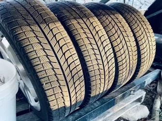

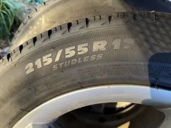

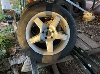

I have a set of Michelin Ice-X on rims that I used on my 2018 Clarity one season here in Connecticut that I want to sell. I bought a 2021 Clarity in February but with the pandemic and without much snow I never put them on last season. They have about 2,500 miles on them (40k warranty). Since I just sold my car to CarMax I was about to put them on Craigslist. They come with the extender lugs. Let me know if you’re interested. If I remember you are also in CT.
View attachment 14154View attachment 14155View attachment 14156
sorry, they were coming up locked after I posted so will try them one at a time.
Sent from my iPhone using Inside EVsView attachment 14168
