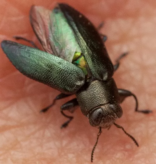

A cockroach has an exoskeleton but doesn't have doors.
Some types of beetles have exoskeletons, but also retractable wing covers. So your analogy here is rather flawed.

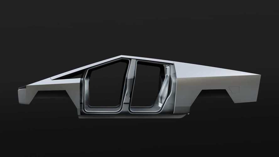

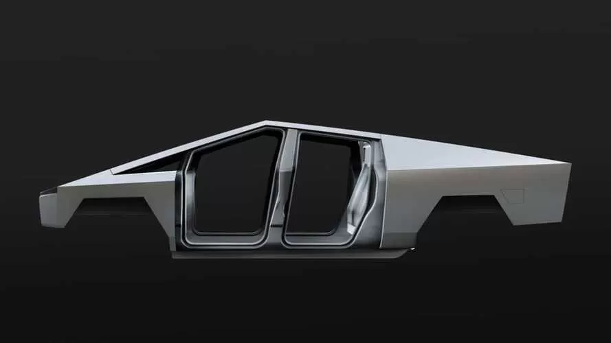

Tesla has also given us this image, which despite the description of a "stressed skin" structure, clearly shows some internal reinforcement around the door frames:
I confess I'm having a hard time seeing how any vehicle supported by wheels can be a fully "monocoque structure"... that is, to have the framework fully integrated into the "skin". In fact, thinking about it, the only vehicles I can think of with strictly monocoque structures would be certain types of boats, including dugouts and lightweight plastic or fiberglass rowboats without a motor mount. But no doubt there are others I can't think of at the moment.
I thank "interestedinEV" for his explanation of the term "semi-monocoque"; from that, I think I understand what it means.
Anyway, I thought the above image was interesting, so I posted it because it relates to the discussion, not as evidence that any of my comments on this subject are either right or wrong. I note that, from appearances only, it seems to indicate (at least to me) that the Cybertruck's structure isn't entirely supported by the "skin" alone. But then, I never thought it was, despite Elon's description. (For example, how could the suspension support the weight of the entire car if it was just attached to "the skin" at a few points?) The image seems -- at least to me -- to support the assertion from "interestedinEVs" that it's a semi-monocoque structure.
