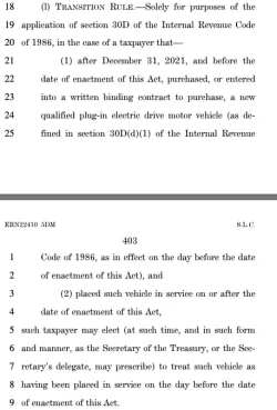

It's fine, there's still a transition rule if you've already entered in a written binding contract to purchase (deposits don't count) then the Secretary of Treasury will count it as the day before the enactment.

Maybe I was reading an old copy of the bill but it seemed to indicate that some of the credit provisions went into effect immediately and the only exception was with a signed, binding contract. Started on page 385 of the bill I think.
