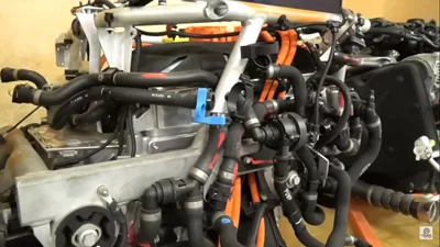

I couldn't find a photo of the heat-pump setup for the Clarity Electric (RIP), an electric Audi or a Tesla, but look at how much plumbing is required around the motor to accomplish liquid cooling with a heat-pump in the electric MINI Cooper SE.
