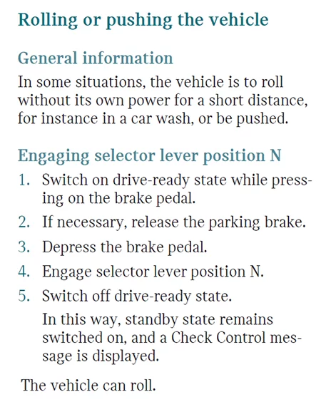

ICE MINIs allow for dolly towing but the BEV doesn't even though the rear is basically identical.
My guess is that MINI decided there was an increased risk of battery puncture from road debris with the car angled upwards behind another vehicle and it was better to ban dolly towing than deal with the potential negative media attention from an EV fire.
To overcome that, you put the car in neutral but that means the car is on. Then, you have to deal with the regenerative braking. It engages the rear brakes with one pedal driving. It wouldn't be safe to have 100% of the braking force to be on the front because in wet conditions, the rear end would get very unstable and want to come around. Check your rear wheels for brake dust to see this. My rear wheels always get dirtier than the fronts.
So it is probably the combination of the parking brake and regenerative braking. That is my guess.

I responded to the other thread with the manual section that does say brakes are sometimes used during regen.
