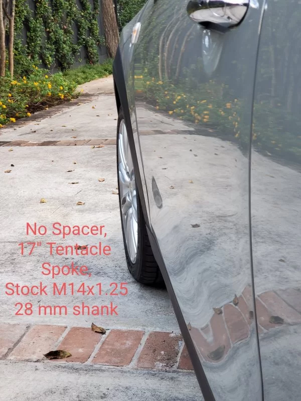

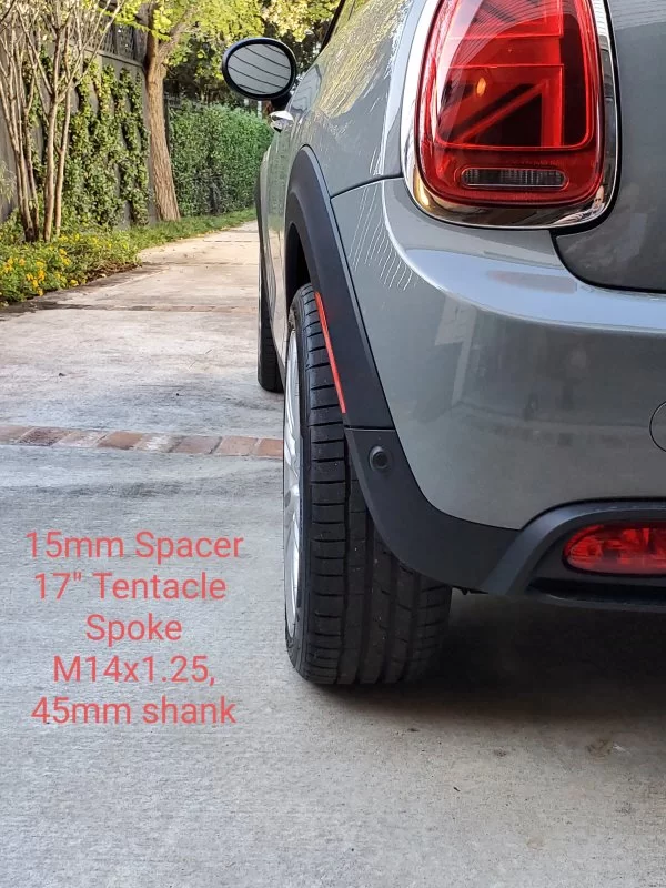

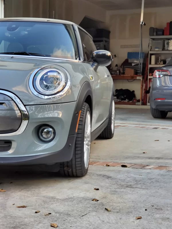

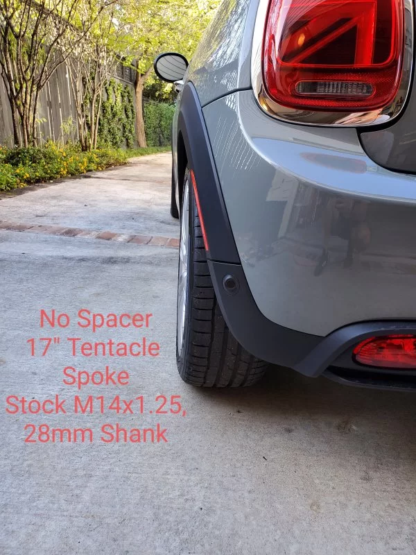

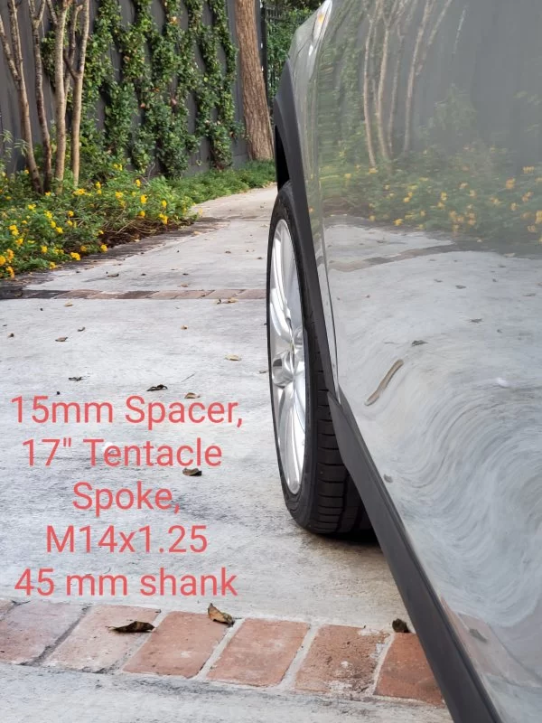

I installed spacers on Jessie, 15mm forward and aft. I like wheels to sit almost flush with the wheel well, so just a little added poke usually does the trick, without having to worry about rubbing or dramatically altering the handling (or, on the SE, the important aerodynamics).
I’ve put all the specs I learned/compiled about the stock wheels, hubs, and bolts, below. Thanks to @idrw’s teaching me about lug bolts, I picked the correctly sized threads and shanks on the replacements to work with the new spacers: 45mm (43mm would have been exactly right, 15mm larger than the stock 28mm, but 45mm worked just fine).

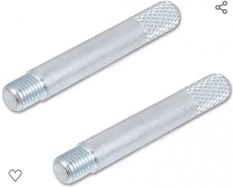

Swapping in the spacers was a piece of cake: just slip them in place and bolt the wheels back on, using the longer bolts. I will say that a wheel hanger bolt made things very easy; after removing the top lug bolt, screw in the hanger, then remove the rest of the lugs. The wheel hanger holds the wheel in place until you are ready to slip it off, and it allows one to slide the spacer and the wheel back on before easily replacing the lugs. Of course, don’t impact them in, use the star pattern, use a torque wrench, and re-torque after fifty miles and again periodically.
I think the final product looks “right” and properly stanced, whereas stock seems, to my eye, like the wheels are undersized, like an economy car’s tucked-in, small wheels.
Here’s the gouge:

@F14Scott, thanks for the tip on the hanger bolts. I will soon be changing my wheels/tires and was wishing MINI used studs and lug nuts like the Hondas I've been driving for the past 34 years, but the hanger bolts solve the problem of locating the wheels while inserting the wheel bolts. Now that @Puppethead has pointed me to the Power Spoke wheel-cover removal tool I didn't know I had, I'm going to have an easy time changing my wheels. This forum includes some very experienced and knowledgeable people!

I could hardly notice the difference but the car looks great!
Yeah, mine are on the subtle end of the spectrum. Some people go bananas poking their wheels way out while lowering the cars, and then there is the "stance" crowd who play with the camber, often to extremes:
I just like the look of the line of the body's outermost flair continuing straight down the outboard edge of the wheel, rather than the outermost flair receding back inboard before intersecting the plane of the wheel.
But, to each his own. There are engineering and aesthetic tradeoffs in all mods.

@F14Scott - Have you noticed any difference in handling performance and/or efficiency after installing the spacers?
Nothing noticeable in either attribute. Handles like a dream, and I average around 110 to 120 miles per charge while hauling *** at 80 on my commute with the AC on full blast to counter Houston's 98 degree afternoons. Milking it, I show 140+.
I just rotated the tires at 10,000 odometer miles (8000 on the tires, as the originals had a dragginess issue). All tires looked like they had even wear; I couldn't tell which were fronts and which were afts, except that I knew their positions already.
After having used anti-seize on the spacers where they contact the hub, they all slipped right off when I rotated.
TLDR: They're just cosmetic, causing neither harm nor performance improvement.

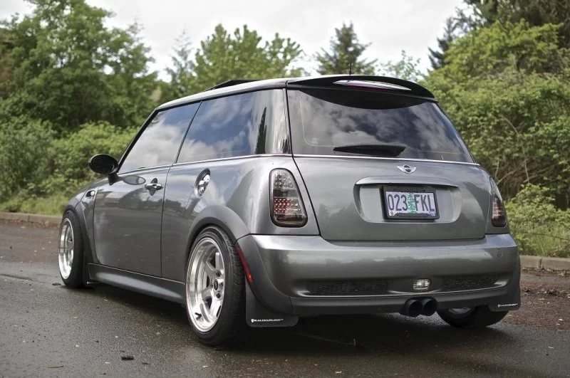

Something like this:
Same problem here, I'm thinking about getting some universal Rokblokz and making my own mounting hardware.
Not sure how they'll affect range but the OEM front ones look useless and I need something since Oregon uses cinder and rock instead of salt which will sand blast the front fender and door behind the tire
That lowered and poked looks really good to my eye, but alas, my driveway's steep angle, my terribly potholed street, and my street's numerous traffic humps conspire to keep me mostly stock.
