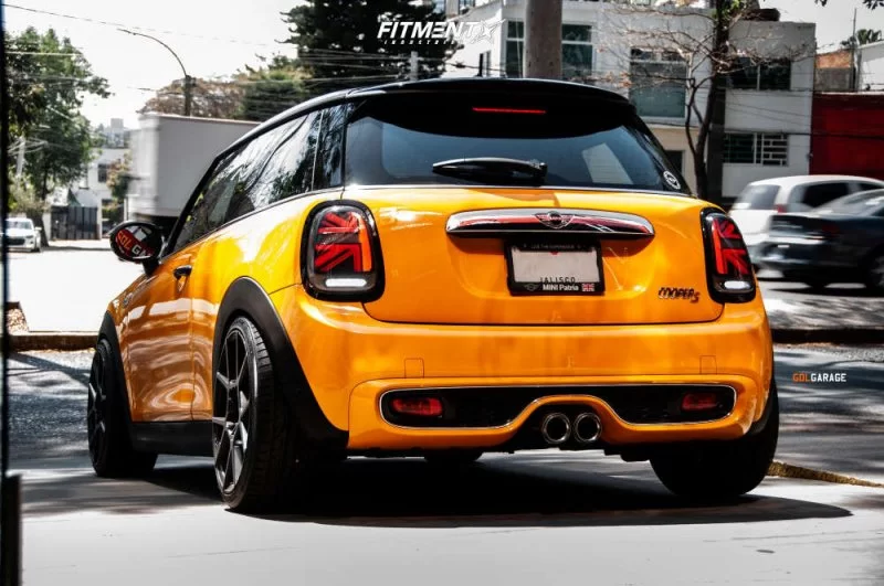

I was looking at this. This is a 18x8 on a 35 offset and I think it looks great. I decided to go with a 17x8.
FYI, the SE has slightly different fenders than the regular Cooper S (just the plastic bit) which may affect fit vs your attached picture.

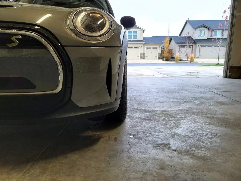

This is 17x7.5 with a 47mm offset and barely clears the shock. To fit an 8" wide wheel, that extra 0.5" would have nowhere to go but out.
  • Like
Reactions: CsD
Looks real good like that! And confirms how good the 17x7.5 w/ 45mm offset will look!
Are you using 205/45/17 tire size btw?
