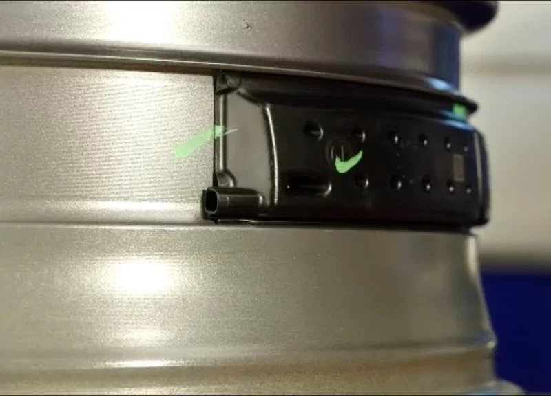

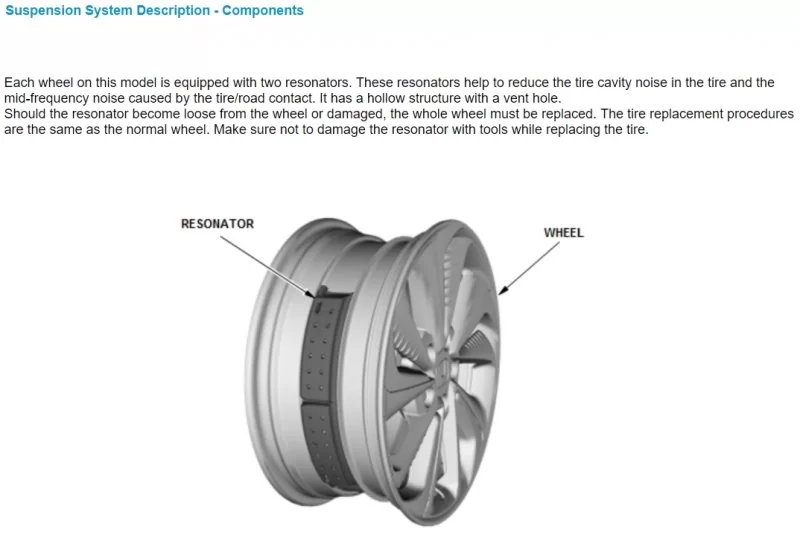

For those who may need to use the Tire Sealant for a small tread-area puncture, I found a couple interesting things on the Honda site.
1) Wheel Resonators are installed onto the center of the wheels to reduce road nose. They are not serviceable or replaceable, and damage will require a New Wheel. However, they can be cleaned.
2) When tire sealant is used, the sealant can be removed and the Resonator must also be cleaned out.
Thought these were important points to be aware for a tire shop as well as a DIYer.

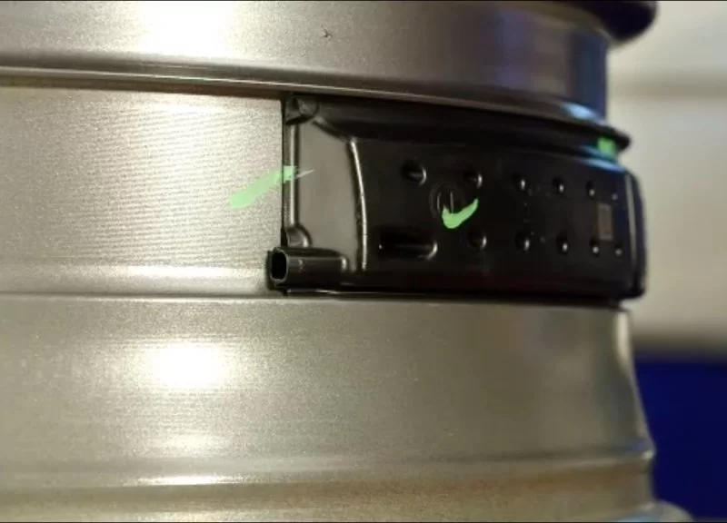

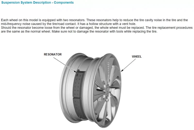

Those resonators help explain why the OEM wheels cost an eye-watering $1100 each. I doubt our much cheaper Clarity accessory wheels have resonators, but I haven't noticed any "tire cavity noise." Do any other cars (such as luxury cars) employ wheel resonators?
I like the looks of the accessory wheels better than the stock wheels, so I put our snow tires on the stock wheels and moved the OEM tires to the accessory wheels. The Nokian Hakkapeliitta (tough to memorize that name!) snow tires I put on the stock wheels are so noisy that the resonators are completely wasted. However, I doubt there are any snow tires quiet enough for the resonators to provide a detectable benefit.
Looking at the photo, I see a green "swoosh." Are these Nike tire resonators? Just kidding.

I remember one of the video said the resonators are designed to match the noise generate by the wheel at certain weight.... If the winter tires weight difference exceed the designed range, maybe the resonators can't do what it is designed to do

The resonators are supposed to generate sound wave that matches the frequency generated from the wheels, if it works well on the original wheels/tires then it will at least cancel some of the noise with snow tires if the weight matches.
