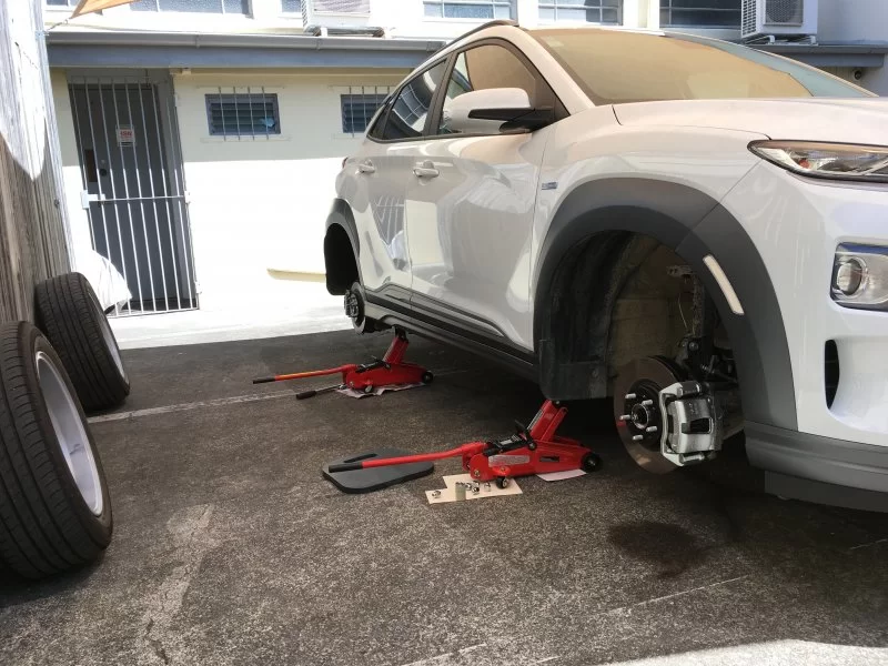

What jack are you using?

Those jacks look exactly like the ones I'm using...

.. But that will be a little more tricky with lifting all 4 wheels off the ground. Or is it possible to lift just the diagonal ones, and the other two would remain planted? Have never done that.
I would be uncomfortable with safety doing that. With two jacks you could lift just one end, swap them left to right, then lift each side swapping front to rear. That's only one more step than just F <> R.
Yeah,... now why didn't I think of that!! Thanks. I can switch both ends and then the front to rears. That will get my currently more tread right side over to my currently less tread left side.

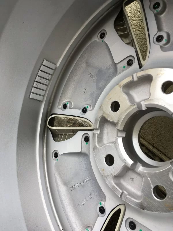

Did my tire rotation today as planned. One thing to note when lifting both rears to do that swap, is that your parking brake only holds the rear wheels. So when jacking up, the front wheels are only held by being in Park, and it could roll forward if you are not careful. Anyway, got it done OK, but it was a bit of work moving all the tires twice to get them into the right cross rotation positions. I measured the tread wear on all of the them and the fronts were around 6/32" while the rears were 7/32. New is 9/32. And they were pretty well evenly worn across the tread from centre to edges. I have 20,000 kms at this point. So looks like I have a lot left to go. At this rate, should be able to achieve 50,000 kms. I run 38 PSI on all 4 tires.
Some have mentioned rust on the inner wheels, rotors and calipers on their cars. I was surprised how clean mine were, despite driving in lots of salt this winter. Having said that, I did wash it frequently.
The vents from the inner hub to the outside are what keeps rust to a minimum. Some wheel designs fail to include this feature and water can accumulate in the pockets.
