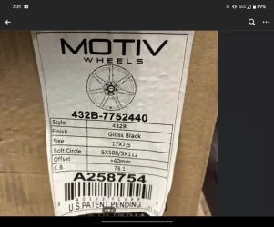

I am getting close to needing to replace my tires. This is the time I typically look at Wheels to see if there are any out there to upgrade to. Can anyone help me and let me know if these will fit on my 2023 SE? It has the 17-in Corona wheels now. Are there any questions I should ask the person selling them? Appreciate your help.

You should be fine when with the stock tires. I'm running 17x7.5 with 45mm offset wheels and the OEM tires with no issues. 40mm offset should give you even more space from the shock than I have.
