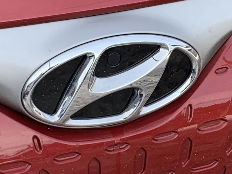

(Sorry if this has come up before.....)
In the middle of the Hyundai emblem at the front end is a light bulb that is almost always off, but I have noticed it lit up a few times. I had a brief look in the manual but did not see a reference. You have to be at the front of the Kona to see it, so I reckon the owner would be mostly unaware when it it lit. I noticed it recently while washing the car. Just asking what it is for and why at the front location? Thanks. ....Rickker
In the middle of the Hyundai emblem at the front end is a light bulb that is almost always off, but I have noticed it lit up a few times. I had a brief look in the manual but did not see a reference. You have to be at the front of the Kona to see it, so I reckon the owner would be mostly unaware when it it lit. I noticed it recently while washing the car. Just asking what it is for and why at the front location? Thanks. ....RickkerView attachment 15109
My understanding; this light indicates your high voltage battery is being used to charge your 12V batt.
The light comes on whenever the HV (high-voltage) battery is engaged but the car is not on. As IGSAD said, one reason for this is the car has turned on the HV system in order to provide power for the 12V system, likely to top off the 12V battery.

The light comes on whenever the HV battery is engaged but the car is not on. As IGSAD said, one reason for this is the car has turned on the HV system in order to provide power for the 12V system, likely to top off the 12V battery.
It's basically just a warning light to let anyone thinking of poking around under the hood that the orange cables are full of angry pixies.
Thanks for the clarification. I won't worry about it anymore.
