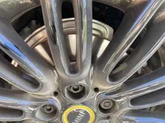

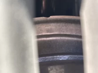

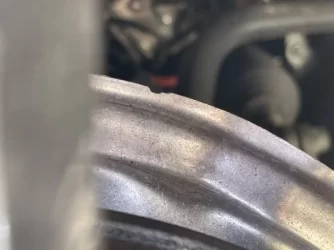

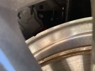

Does anybody know what is that metal thing behind the front brake disc, pic attached.
And have you noticed them as being chipped? If they are normal, looks to me they are not the same i.e. not machine done at factory?

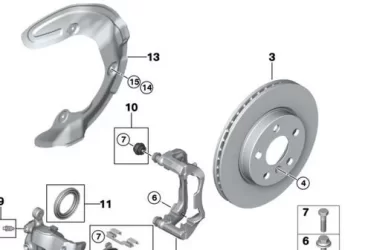

Should be your brake dust shield. If you ever get this weird grinding noise coming from a wheel, it's probably a rock stuck between the shield and the rotor.
Dust shields are on all cars with disc brakes and are just stamped steel. There is a small gap between the dust shield and the rotor so it is possible to get something stuck in there which is bad. The most common thing to get stuck is a rock and it is very uncommon but it does happen. If it does happen, it will make a speed dependent high pitched noise as you drive.
Thanks, everyone. I learned something new. I now know those chipped edges are normal. The grinding sound has stop probably the small stone has been dislodged.
