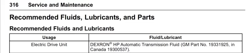

Although it did not come up with my search, I now have noticed transmission fluid mentioned on p. 310 of the manual. This is so strange to me. I
Yes, the Bolt uses transmission fluid. But the Bolt does not have an automatic transmission and doesn't need a transmission fluid flush.
