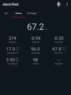

374V at 67% SOC. This info is shown in the electrified OBD app:
