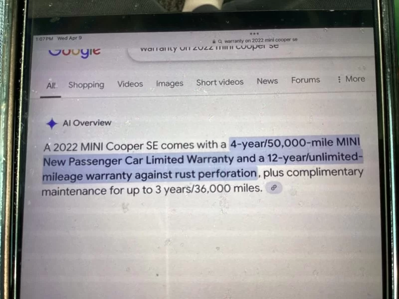

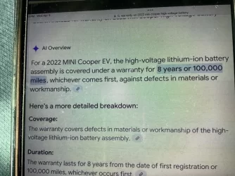

Out of warranty items can be taken to your local shop, but the HV battery could still be under warranty.

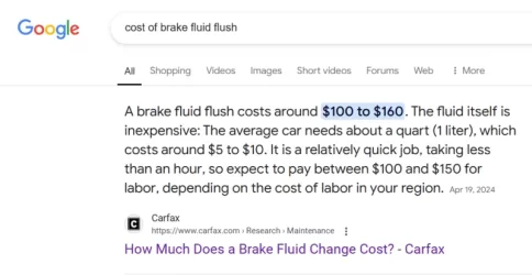

I've never changed the brake fluid in anything i've owned unless i needed to bleed a line or it was a race car where the fluid boiled from extensive heat. In theory, there's a 4 year service life for most fluid. I'm on year 7 in my truck. 0 issues.
Unless you're feel spongy brakes, i don't see the point. and certainly not for 700. It's a $25 can of fluid, 4 bleeder/screws, and a refill cap and a partner to pump and bleed. 15-30 min job with the right tools and a partner to push the brake pedal for you. $200 would be a reasonable price IMO.
a quick google agrees:
Do an alignment when you get tires or suspension parts. Not a lot of need otherwise unless you've slammed a pothole.
'check' usually means look at and not worth paying for. unless they are pulling diagnostics, which should be free, it's not worth it.

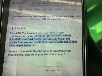

To me 2 years brake fluid replacement is as BMW/ Mini SE or dealers making money as mini SE call for 2 years flush brake fluid and brakes are use on SE 90% less than gas car no much heating in piston brakes bc of regen brakes what is an explanation/ hydroscopic crub absorbing water/ rust and why a gas Cooper calling for flush brake fluid (every 30000 miles . My SE 20000 miles 3.4 years old fluid was changed 2 years ago I should have fluid change in next 2 years means car will be over 5 years old to reach 30000 miles as I drive not much but will be 5 years old where is a logic to push for 2years intervals and I wonder if those flushes brake fluid evacuate a fluid from ABS unit which is critical to do job correctly or those flushing is mediocre job .Next brake fluid on mySE will be Ate DOT4 low viscosity for $ 20 a liter/qt on Pelican web. Made In Germany will be done myself
.Just to make a point driving for over 50 years maintenance all my cars myself I never developed brakes fluid problems as my Hondas VW MB Fords Chevy Plymouth and 1975 911 and more I have never change to new brake fluid just add correct DOT to reservuar or I was just lucky? We not talking about low milage I did 400000 miles on Fords Escorts in NY driving around for jobs 3 all of them hatchbacks.
